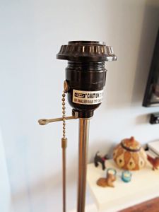

Step 1: Ikea Socket, Too Large for Regular Lampshades
Yes, it's the socket that's the problem. It's too large to hold regular lampshades. You guessed it: change the socket.
Step 2: Broken Socket.
It was not budging, it was not unscrewing, it did not want to move. I accidentally broke the socket trying to get it off. That's when I realized that was the only way this one was coming off. Hopefully your experience will be different!
Step 3: Attach New Base.
Attach the new base, pulling the wires through beforehand. Next up, wire the socket. Super easy.
Step 4: Voila!
You now have a new socket that will hold any lampshade! Well, sans an Ikea one. The lampshade world is your oyster now.
