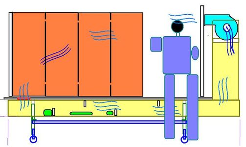

OK this is not a photo but a drawing of the project prior to construction.
It shows conceptually what I was trying to achieve. This sketch was done using the Paint program that comes with all windows package suites.
