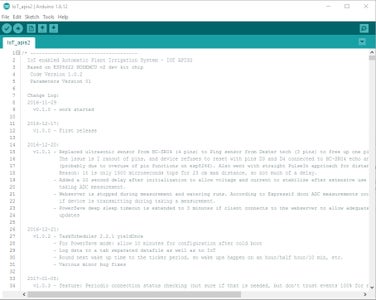

Step 9: NodeMCU Sketch
NodeMCU sketch implements several features of IoT APIS v2:
- Connects to the existing WiFi network -OR- runs as a WiFi Access Point (depending on the configuration)
- Queries NTP servers to obtain local time
- Implements webserver for plant monitoring, and adjusting of watering and networking parameters
- Measures soil humidity, bottom tray water leaks, water level in the jar, and provides visual indication via 3 color LED
- Implements online and powersave modes of operation
- Saves information about each of the watering runs locally in the internal flash memory

Step 17: Sketches and Files
IoT APIS v2 sketch is located on the github here: Sketch
A few libraries used by the sketch are located here:
- TaskScheduler - cooperative multitasking library for Arduino and esp8266
- AvgFilter - integer implementation of the Average filter for sensor data smoothing
- RTCLib - implementation of the hardware and software Real Time Clock (modified by me)
- Time - Modifications for the Time library
- Timezone - library supporting time zone calculations
NOTE:
Datasheets, pin documentation, and 3D files are located in the "files" sub-folder of the main sketch.
HTML files for the built-in webserver should be uploaded to the NODE MCU flash memory using arduino-esp8266fs-plugin (which creates a filesystem file from the "data" sub-folder of the main sketch folder and uploads it into flash memory)
