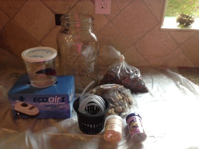

Step 1: What You Need
1. Air Pump
2. Bubbling airstone
3. Clear pipe that will go with the Airpump more than 3 feet.
4. Organic Wheat grass seed
5. Clay pebble as your growing medium.
6. Plastic net cup to fit your mason Jar. 3.75 inches wide is what I am using.
7. Mason Jar -1 gallon (Some people suggest having 2.5 gallon at least for betta tank) This is a controversial topic. Since Walmart and Petsmart, and other licensed company sell smaller than one gallon, I will leave it to your love for betta to select from what is adequate to what is desirable. This debate is endless.
8. Beta Fish and Betta fish food
9. Stone for fish bed.
10. RO water to fill the water
11. Microbe-Lift Nite-Out II Nitrifying Aquarium Bacteria- I have used one drops
12. Decoration (optional)- since it is my first time I did not want to use any additional stuff.
13. 2 Large Led Candles(optional)
14. Pond snail.
15. Beta heater- Based on comments I incorporate this in my system. Thanks to all the folks for there suggestions.

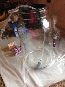

Step 2: Assembly
1. First start with cleaning and drying all the stuff with water.
2. Run the pipe through the net pot and the end of the pipe attach it to air stone. Remember to leave extra lenght of pipe inside the jar as we will need to pull the net pot our to feed the fish with out pulling the air stone out of the pebbles.
3. Now Place the air stone and betta heater in the bottom of mason Jar and cover it with stone that were washed with cold running water. Bettas like warm temp of 80 degree.
4. Fill the Mason Jar with water and insert the Betta fish. Remember to put fish food as recommended and also mix in the Nitrifying Aquarium Bacteria liquid drops in the water. I have used 2 drops for one gallon water.
5. Start the air pump and check that it is working and adjust air bubble stone nicely under the aquarium stone so that it does not floats up. Adjust the speed as well at this time. I have kept mine close to minimum.
6. Now cover the mouth of the mason jar with the net pot. Be sure to check the size so that the net pot sits on top and not not sinks in the jar.
7. Make sure that half of the net cup is covered with water. If it is less fill in more.Also betta like to come up to the surface to breath. so make sure there is gap between the brim of the jar and the water level. I see my betta come up many a time.
7. Cover 3/4th of the pot with clay pebbles.
8. Wet the wheat grass seed with water for 30 min and put them over the clay pebble. Soaking the seed help them to germinate faster. I have used organic seeds.
