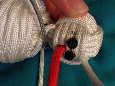

Step 5: The Eyes
To make the eyes, grab the black paracord cut the end off. Now burn the end and stick it where you want the snowman's eye. After it is stuck to the monkey fist cut the rest of the paracord off, leaving about 1/4 inch for the eye. Burn the end of the cord and color with black sharpie when cooled.
Repeat this for the other eye.
