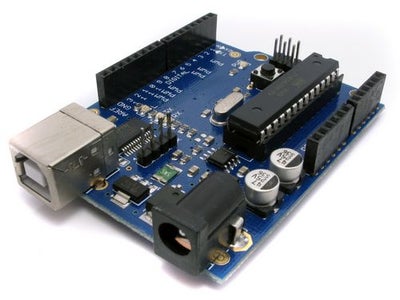

Step 3: Setting Up Your Arduino and Breadboard
CDS Cells
The light sensors being used are actually called CDS cells or Light Dependant Resistors. They change resistance based on the amount of light hitting them. The sensors are very small, which makes it difficult to aim a laser at them from across the garage. To solve this problem, we put the CDS cell inside a carboard tube with velum paper or tissue paper covering the opening, and black tape covering the back side. The paper provides a larger target to aim the laser at, and it helps block out other ambient light and strobe lights in the haunted house.
Beacon Light
The Arduino turns on a 110V red police light when a laser beam is broken. To avoid interfacing the Arduino directly with 110V mains power, I hot glued a servo to a power strip. The Arduino activates the servo, which turns the switch on the power strip on or off.

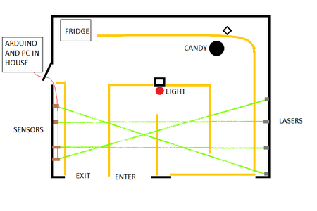

Step 4: Putting It All Together
Set Up Your Garage
Build a path or a maze for trick-or-treaters to follow as they dodge the lasers. An easy and inexpensive way to make walls is to use cardboard or PVC tubes attached to the floor and ceiling, and wrap caution tape between them to form walls. The caution tape also leaves plenty of space for the lasers to pass through. After you have the walls built, set up the red light and power strip/servo you prepared. Make sure you have enough wire attached to the servo to reach your Arduino.
You will need a fog machine so the lasers beams are more visible. There are several Instructables for fog chillers if you want the fog to stay low to the ground, but it isn't necessary. It also helps keep fog in the garage if you block off parts of the garage doors with cardboard walls or some other kind of barrier to keep wind out and fog in.
Set Up The Lasers
The lasers are not connected to the Arduino or PC in any way. The laser pointers come with AAA batteries by default. The batteries die quickly when you leave the laser on constantly. You can leave the battery cover off of the laser case, and power them with D-cell batteries instead. This will help extend the run time, and it will provide a more constant brightness. Use alligator clips or solder to connect wires to the spring(negative) and threaded part of the laser case(positive). Two D-cell batteries will power 2 laser pointers for over 6 hours. Each green laser pointer draws around 250-300mA, so keep that in mind if you come up with an alternative way to power them.
Once you get the lasers powered, position them in your garage. Put them 4-8 inches off the ground so that costumes with dresses or robes can make it over them. Use L brackets to fasten the lasers to the wall, or mount them on boxes or wood blocks. Use black tape to hold the power button on. The floorplan picture shows how I set up the lasers and walls in my garage. I put a caution tape or cardboard wall in front of the lasers and sensors to prevent people from accidentally bumping or kicking them.
Set up the Arduino and PC
With the lasers in place and powered on, it is easy to position your light sensors. Mount the light sensors on the opposite wall so the lasers shine directly on them. Make sure you have enough wire on your light sensors to reach your Arduino. Plug in your light sensors and servo to the breadboard according to the circuit diagram on step 3. Plug the USB cord in to your Arduino and PC, and start up the Processing program.
Remember that you can use the Arduino's built in reset button to get a new average light reading and alarm trigger values as the ambient light and fog in your garage change. The bar graph display from Processing should help you get everything tuned and working perfectly.

Step 5: Behind the Scenes - Arduino Code Detail
The Arduino code is in the LASER_Maze_2012.zip file attached to step 2 of this Instructable.
This step is just here to provide more information on how the Arduino code works.
The Arduino uses the analog inputs to monitor the value of 4 light sensors that are set up as voltage dividers. As soon as the Arduino is powered on, it averages together 3 readings for each light sensor. The average is the normal or expected amount of light when a laser is hitting the light sensor. If the light sensor value falls too far below this average, the Arduino knows the laser beam has been broken and sets off the alarms (activates the servo and sends the alarm signal to Processing).
You can calculate a new average and new alarm level by pressing the built in reset button on the Arduino. This is useful if the amount of ambient light or fog in the air changes enough to interfere with the sensors.
The Arduino also communicates with Processing using the Serial communication library. Each time a sensor value is read by the Arduino, it is sent to Processing to be displayed as a bar graph. When the alarm value for each sensor is calculated, it is sent to Processing to be displayed as a red line on that graph. The Arduino also sends a signal to Processing when the alarm servo is turned on or off. The signals being sent from Arduino to Processing are just numbers. The ones digit of the number lets Processing know what type of data has been sent, and the rest of the number is the actual data.

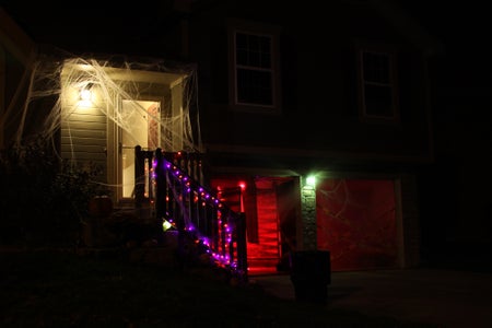

Step 7: The LASER Maze in Action - Photos
Photos of the LASER Maze 2012!
