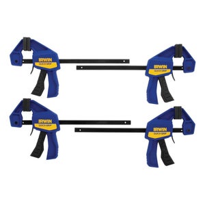

In addition to a cnc laser cutter, you will need a few quick release clamps or rubber bands.

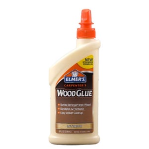

You will also need some wood glue. Any wood glue will do, but I used Elmers wood glue. You can also use hot glue or super glue, but wood glue will give you the best results.

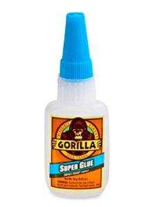

To join the acrylic and wooden pieces, we will need a different glue. You can use two part epoxy for this, but I try to avoid expoy as it is smelly and messy. I used super glue for this part.

Next, we are going to begin by assembling the wooden parts. They slot together pretty tight, but nonetheless we are going to add a dab of wood glue to cement it in place. To do this, apply a line of wood glue down the wooden piece (with the instructables robot) underneath the slot. See the 4th image to see exactly where I put the wood glue. Next, slide two opposite wood pieces together. Two of them have upward facing slots, and two have downward facing slots. You''l want to slide a downward facing one onto an upward facing one. Repeat this step 3 times until all the wooden side pieces are slide together.
Next, I super glued the acrylic on. If extra super glue drips onto the acrylic, it will ruin the surface finish, so be careful. I think the best way to avoid this is to apply a tiny bit of super glue to each of the fingers on the wooden part, wait about 30 seconds for the super glue to kind of seep into the wood, and then put the acrylic piece on. My super glue takes a few minutes to dry, but if you have 15 second super glue, obviously don't wait 30 seconds before putting the acrylic piece on.
