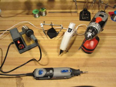

Tools:
Soldering Ion
Hot Glue Gun
Drill
Dremel (Not necessary but good to have)
Wire Cutters
Wire Strippers
Helping Hand
Safety Goggles

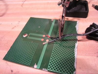

Step 6: Wire Up the Solar Cell
If you're not making a solar powered version of this kit, skip ahead.
In this guide I'm using a 5.5V 320mA solar cell which is encased in a hard plastic. Any large solar cell will do, but ideally for the Charge Controller you want your solar cell between 5-6V in power.
Take the end of the Male Jack Wire and split it in two. Then strip the ends a bit.
The wire with the white stripe is negative, the wire that is all black is positive.
Solder the wires to the appropriate tabs on the back of the solar cell.
Use either electrical tape or hot glue to cover the solder points. This protects them and helps relieve strain.
