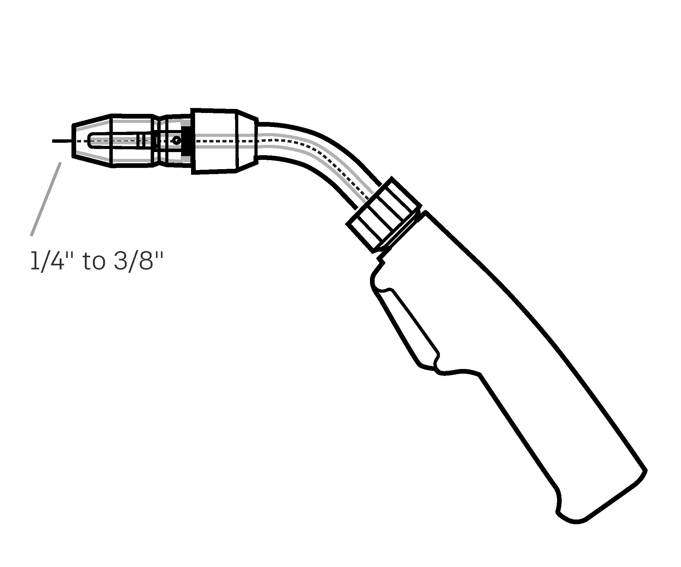

The MIG torch has 3 main parts, plus the wire.
- Torch body
- The handle and trigger
- Contact tip
- The tip attaches to the end of the torch.
- If the contact tip is damaged, see Shop Staff for assistance.
- Gas nozzle
- The replaceable nozzle slides or screws on the end of the torch. It helps to focus the shielding gas out the end of the torch.

- Cut the wire so it sticks out 1/4" to 3/8" from the gas nozzle.
