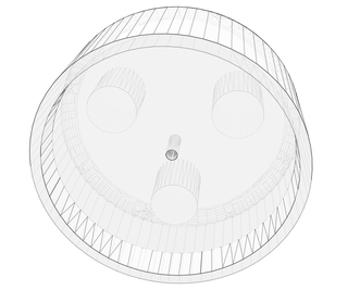

Helping hands with Magnifying glass and clips that can be placed in any position. This system uses a magnetic base that works well with the BH-1 Mobile work station. Base and Glass holder are 3D printed parts. If you don't have a 3D printer, contact me and learn how to acquire a set of your own.
File HH_TriMount.stl is the Base, MG_HolderP1.stl is the Magnifying Glass ring and file MG_HolderP3.stl is the Ring holder. You may need to rotate the last file 180 before printing.

Step 3: Prepare the Base
Parts needed:
  • 3D printed helping hands Base
  • 2 x 1/4" cup magnet
  • 1/4" NPT pipe thread tap
  • #6 x 3/8" wood screw
Use the Pipe thread tap and thread each of the 3 holes on the top side of the base. Insert the magnet into the bottom side of the base and secure in place with the wood screw.
Step 4: Finale Assembly
Screw the 3 coolant pipes into the base. Place on a metal surface and enjoy your better helping hands.
