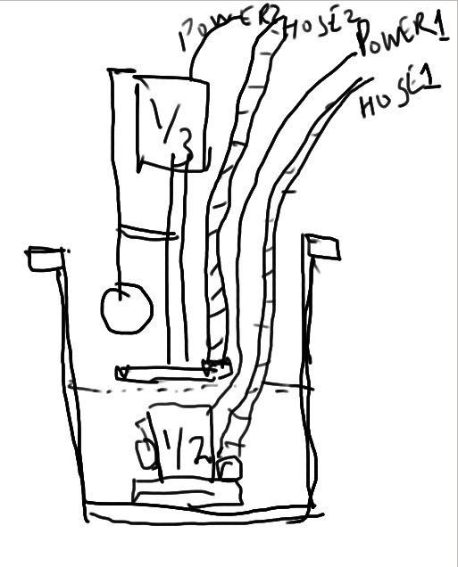

I live in New Jersey and as I write this instructable on October 28, 2012, we are about to be pounded by hurricane Sandy, To keep my sump pumps going, I decided to buy a portable generator in case the power goes out. The only generator I could get my hands on is this behemoth 225 lbs Generac 5500 watts generator. Keep in mind that I cannot run this generator in a covered open area. First on all, other than my small covered porch I do not have any other covered open area, secondly with 100 miles an hour wind, there is no such thing as covered and open. I had to make a cover which will protect the generator from rain and I will need to provide ample opening for it to breathe and dump its exhaust.
