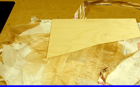

You will need a ton of bags. I think I counted 30 bags by the time I was done with the tote bag. You will need an iron that can be set to low heat and some scissors, aluminum foil and something hard and flat. I used plywood.

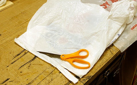

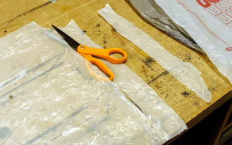

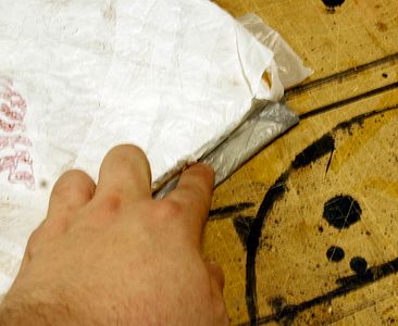

First I cut the bottoms off the bag.
Next cut the handles from the top of the bags.
I then cut up the side of the bag and open it up.

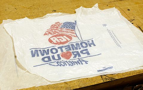

Next, cut the logos and any other ink from the bag. If you leave the printing on it will be difficult to add color and graphics later that stand out.
Now cut strips from the bag by making vertical cuts every 1.5 to 2 inches apart.
I like to place the different types of colors in separate piles.

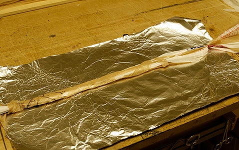

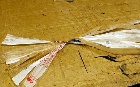

I made my handles with long cuts of plastic by cutting the bags longwise without cutting the ink areas out you can get plastic strips long enough to make strong handles.

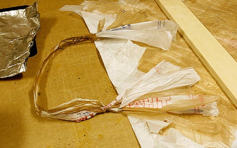

First gather six long strips and tie a knot where you would like the handle to start and tie another where you would like the handle to end.
I take a single strip and wrap it around plastic strips starting at one knot and ending at the other knot.
With your iron on low cover the middle handle area between knots with foil and make a couple passes over the foil. Be careful not to touch the unprotected plastic with the iron.
Take a look at your progress if it looks like the layers are fused together flip the handle over and iron the other side.

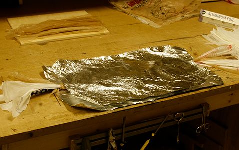

Layout two sheets of foil side by side. If you want to make a bag that is 25" tall by 20" wide you will need 50" lengths of foil by 20" across.

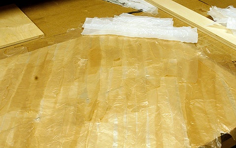

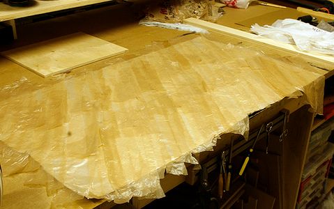

Start laying down your first layer diagonally over lapping the strips as you go. I used brown bags for my first layer because I had an overabundance of them.
Next I lay down my second layer diagonally as well but in the opposite direction then the first layer. For this layer I used all white. I guess I was thinking that a blank canvas starts out this way so I would do that as well. also I did not have a large variety of colors to play around with.

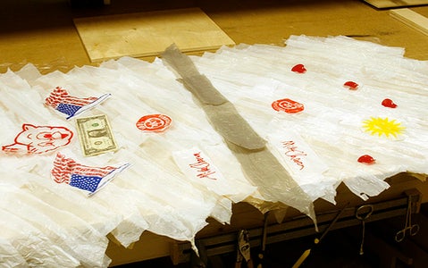

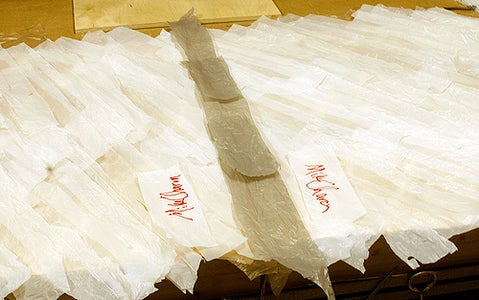

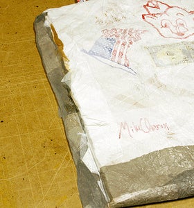

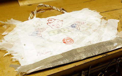

I wanted to see how a grey strip across the bottom of my bag would look so I put gray plastic strips along the center line. Also I signed my name with a red sharpie on two strips of white plastic to see if artwork drawn on plastic bag parts would turn out and it did.
I also cut graphics from other plastic bags and used them on mine.
Arrange your graphics and colored plastic bag parts on the "canvas"
By the way because shrinkage occurs during the fusing process it is not reliable to use anything that is not able to shrink or bond to the plastic with heat. As you might be able to see I used a dollar bill as a test and it did not turn out the way I had hoped.
I think people in big cities will have the best bags to choose from for colors and graphics so those of us out in BFE will have to draw our own with sharpies.

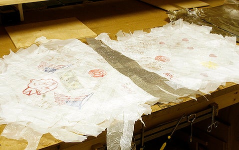

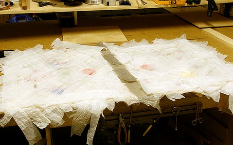

You will need to add one more layer of plastic bags to you project to seal in your graphics.
I try to save all the clear or translucent white bags for this step.

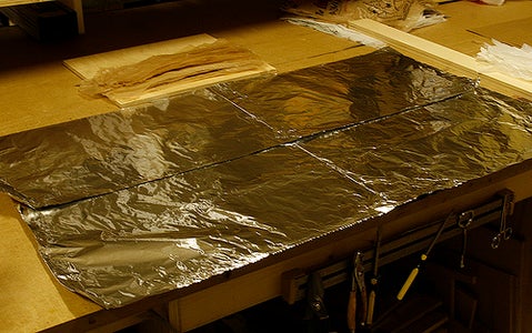

Carefully cover the main area of the project with two pieces of foil that match the size of the first two.
You will want the edges to remain unfused so we can join the two sides by fusing later.
Alright lets take that low heat iron and starting at one end move the iron over the foil in a pattern that applies heat to all areas you have the foil over.
As the plastic cools it will shrink a little. the shrinkage will cause bunching but you can fight the bunching by applying pressure with your flat object (plywood in my case) right after the heat is applied. Remember that too much heat is not good as it will create burn thru holes and unless your going for that crispy look you will want to avoid this.
once the top is complete and your graphics are sealed in you should flip your project over and run the iron over the opposite side.

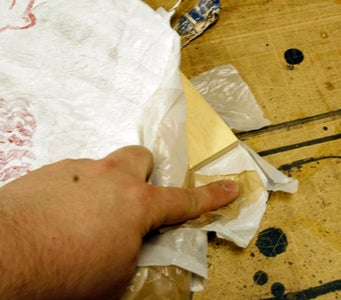

I found that by using a square of plywood inside the bag area while fusing the sides helped keep the edge straight as I fuse.

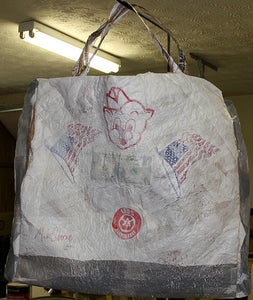

Step 10: Done!
Now you should be done. And I hope your bag looks a lot better!!!
