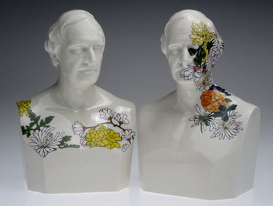

Introduction: Making Alphonso Taft- From 3-D Scan to Ceramic Sculpture
This instructable will narrate the process of creating a ceramic sculpture from a 3-d scan, which includes mold making for slip casting ceramics and hand carving a plaster model sconce for display.

Once the mold is clean and dry strap it together and pour the casting slip. The material will remain in the mold until the desired thickness is obtained. When ready the excess slip is poured out and the mold will sit until the clay shell becomes rigid enough to hold form. Mold parts are then sequentially removed revealing the clay reproduction. Clay shrinks so think of that before hand. The digital model for this project was scaled considering the shrinkage of the porcelain to obtain the desired dimensions.

After the high temperature glazing, the surfaces were hand painted and fired multiple times with overglaze enamels and gold luster.
