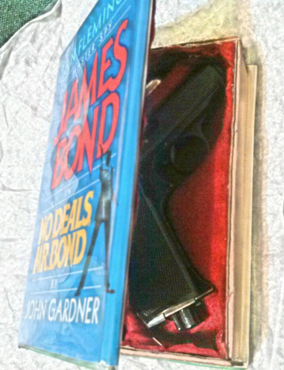

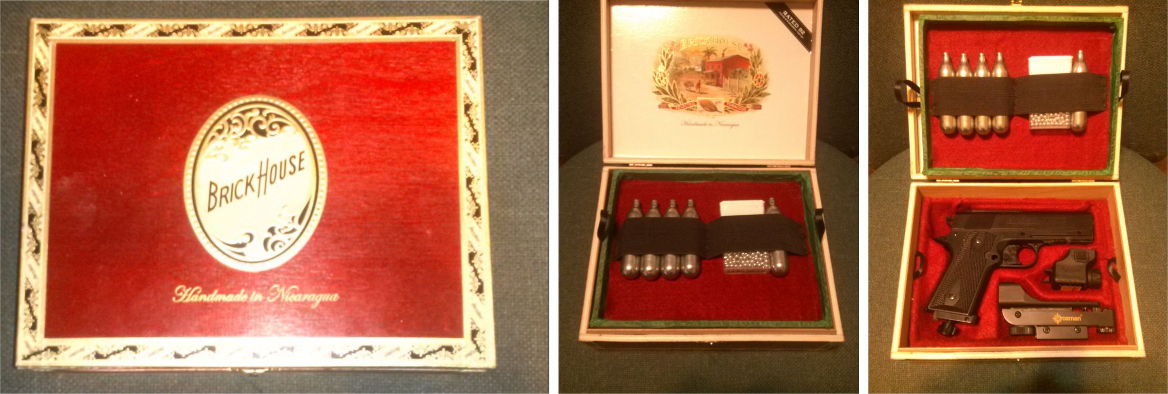

This is a simple plastic case, with foam rubber lining the top and bottom of the case.  This provides only minimal security, as the only thing keeping the pistol from sliding around in the case is friction.  A sharp blow, as would be experienced from a fall, could allow the pistol to impact the edges of the case, potentially causing damage to relatively delicate but vital components, such as the sights or the magazine lips.  Any sturdy case or box can work; possibilities include old instrument cases, wooden cigar boxes, or even hollowed out books.
