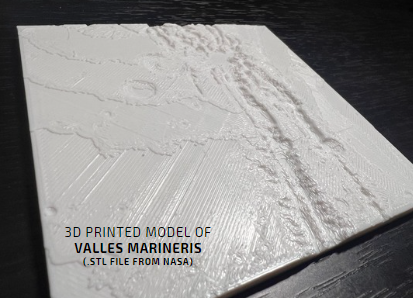

After carefully considering the list of sites, I selected Valles Marineris because of its close alignment with the criteria for habitation (low altitude, protection from dust storms, water supply, and warmth). I 3D printed a model of Valles Marineris from NASA's website (link: https://nasa3d.arc.nasa.gov/detail/valles-marineris) to better visualize its topography (shown in the picture on the right). Within the Valles Marineris, the Melas Chasma section is the most ideal location. This canyon is the broadest portion of the Valles Marineris and is just barely South of the equator. With promising evidence of water, it is the most ideal location for constructing a human habitat.
