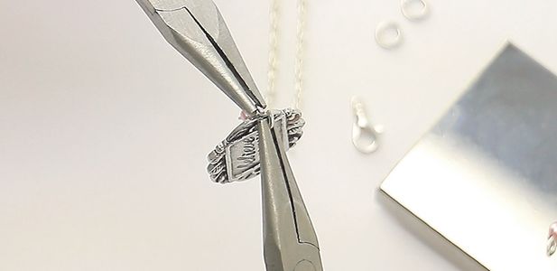

Step 11: Attach the Beads to the Stamped Pewter Blank With Jump Rings
- Hold one pair of chain nose pliers on each side of the opening
- Move the ends past each other to open and close the jump ring
Step 12: Assemble the Bracelet
Attach the chain and the clasp using jump rings.
Step 13: Check the Jump Rings
- Make sure that the jump rings are closed securely by moving the ends past one another laterally.
- You will hear or feel a “click” when the jump ring is closed properly.
