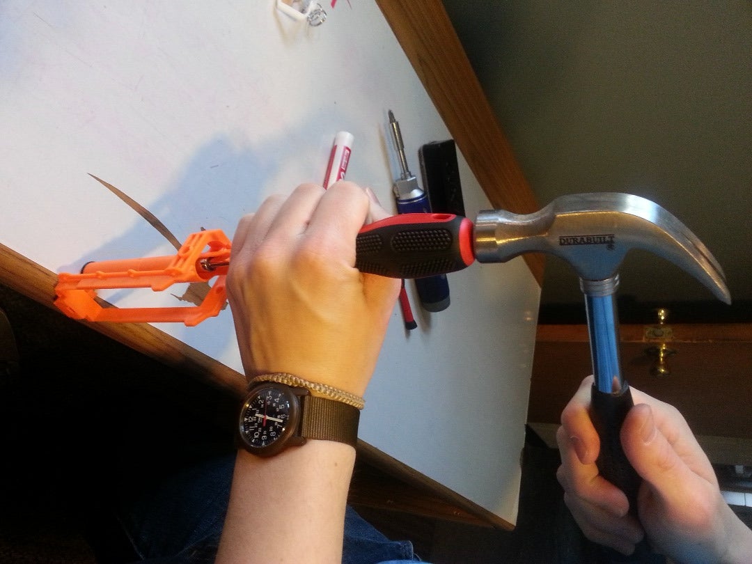

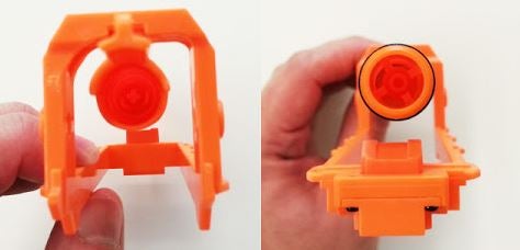

Step 3: Locate the Air Restrictor
Remove the spring and piston unit. This should be relatively easy, but be careful to not break anything. As you can see, the air restrictor does a good job of restricting air. It's kind of amazing that any air can pass through at all!
Step 4: Remove the Air Restrictor
This is where you get to be creative. Take your time with removing the air restrictor because the plastic is relatively fragile. My tools of choice are the long screwdriver and hammer combination. If you have a drill with a long bit, that would work well too. Basically, you want to remove everything within the shaft without damaging the shaft itself.
Trouble? If you do happen to break any of the internals, you can buy new and reinforced internals from Mod Works. http://www.orangemodworks.com/category_s/1845.htm
