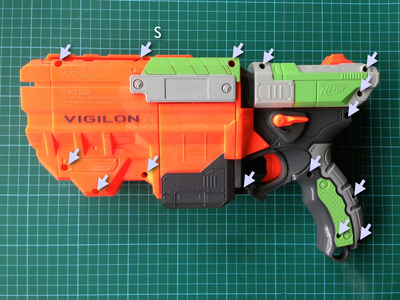

Start by removing 15 screws on the left side of the Vigilon. 14 of these screws are about 11.5mm in length. 1 is only 9.5mm in length, and in the attached diagram is marked with an 'S' for your reference.

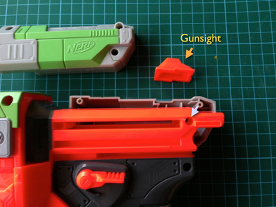

There is one more screw under the slide assembly. Take note also of the alignment of the gunsight for easy re-assembly after the mod.

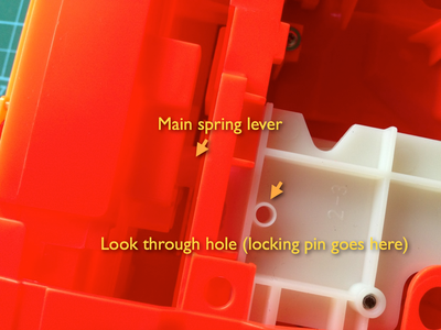

Pulling back the charging rod SLOWLY, you will notice that it clicks as you slide back, and at one of the clicks, the charging rod actually locks with the main spring lever BEHIND a hole in the white spring assembly.
Lock back the main spring lever by inserting the 3mm rod into the hole, in front of the lever, past the other side of the main spring assembly. I believe this hole is also used during the factory assembly process for this same purpose.

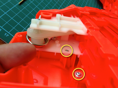

On the right side of and behind the main spring assembly, remove two screws. One of them is flanged, for your reference.The one without the flange locks down the main spring assembly, and removal of the second flanged one gives you some allowance as you remove the front cover.

To remove the main spring assembly, first locate and remove two screws locking down a retainer plate.
Once the retainer plate is removed, slide the main spring assembly forward until is seems stuck, then rotate the whole assemble counter clockwise about 30 degrees before sliding off the assembly completely.

Once the main casing is back, remember to first replace the screw at the end (the one that was below the slide), and its time to replace the slide and all the other screws.
I have the screws location diagram here again for your reference, especially where that ONE short screw is supposed to go.
