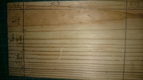

Step 2: Base Plate
I first cut a wooden plate in 17 x 10 cm size,
draw a 3 x 5 inch smaller rectangle on center
and make the 4 points on corners as marks for drilling hole later
then draw the carving pattern for the decoration, i carved a Camellia as practice ( i also try to learn carving skill, is for beginners)
before drilling the hole, i first carving the Camellia flower
after cleaning the debris, clamping the plate and Use 8 mm diameter bur to begin drilling on the marked corners, then took a chisel to carve the round tunnels into square tunnels (9 mm) one by one for the square pillar rods
(after doing this, i should use round dowels as support pillar, because it is so difficult to make accurate square hole by hand carving.)
