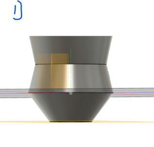

Step 1: Make the Main Body
1) Create a new sketch on the XY plane. Sketch a center diameter (c.d) circle with a diameter of 3 in. Image 1.
2) Construct an offset plane 1 in above the first sketch. Create a new sketch on the offset plane. Sketch a c.d circle with a diameter of 2.5 in. Image 2.
3) Construct an offset plane 5 inches above the first sketch. Create a new sketch on the offset plane. Sketch a 5" (horizontal) by 4" (vertical) ellipse. Image 3.
4) Loft the first two sketches together. Loft the second two sketches together. You're model should look like the 4th image above.
