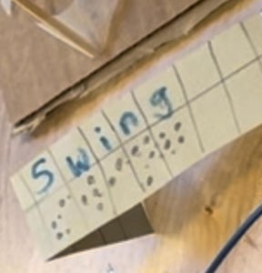

Consider reading to students the Six Dots book/video about the origination of Braille Alphabet. You will need to project the Braille alphabet. One is shown in the second video, minute 3:00.
Students will create a small one word Braille sign for their structure, ie. slide, swing, seesaw...or an action word like play, climb, sway, spin, bounce, dance...Many students love the Rainbow Harp from the Magical Bridge playground!
PREP: half sheet of construction paper, pencil, ruler, scissors, pushpin* per student (*wait until very end).
ACTIVITY:
  1. Using a strip of construction paper the size of a ruler, have students use a ruler to then mark lines across the strip every one inch, creating boxes. Our strips were bigger so I had students use the straight edge to draw a long line lengthwise to create boxes for 5-7 letters.
  2. Have students write a letter into each box and then the evenly spaced dots pertaining to the letters.
  3. From behind the paper and each dot, students will use a push pin to poke through the paper making a raised little area that you can feel from the front.
  4. Older students may be able to write the Braille dots in reverse on the back using a projected alphabet in "mirror" view.
  5. If you plan to teach students Tinkercad, let them know they will get to 3D model a sign there too.

  3. Next, project the Braille Alphabet and challenge students to create a one-word sign using the Scribble tool to make the dots.

Printing signs: the Swing sign pictured above took only 30 minutes to print! (Or email files to a printing service.)
