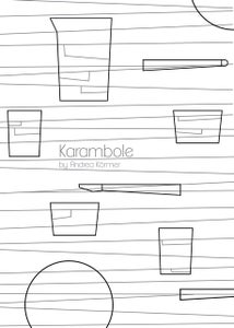

Step 2: Inspiration and Sketches
Pic 1: inspiration for 'folded paper'.
Pic 2-4: some sketches of mine done after trying the technique of bending and folding. The ideas of cups, bowls, plates and a lamp started to get real.
