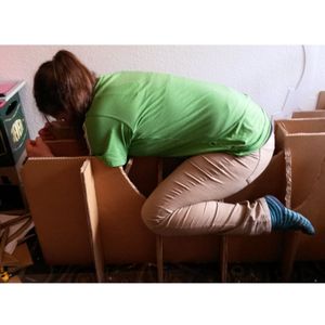

Step 2: Premodel: Ergonomics and Steering Function
To find the ground shape of our basic construction and even the form for the ergonomic proportion, we built a crossed structure out of strong corrugated paper. From here on we could find the perfect form fitting to our bodies. Then we cutted out and off all the parts we don't need to fit in the Bobby Car and finding the best positions for feet and hands. (You need to know, we had a lot of premodells..) The idea for the steering functions appeared after a lot of other technical models, so finally this one you see is working and can be connected between feet and the Bobby Cars steering wheel. The function of the front wheel to us it as a crank handle wasn't neccessary to "premodel", it was working directly by just trying in original size.. puh!
