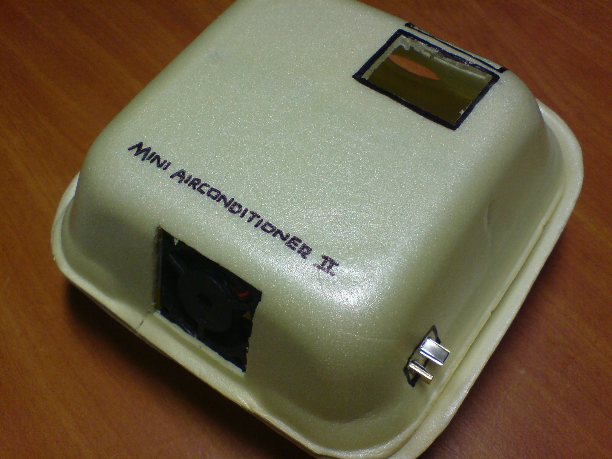

Step 6: Tada! You Are Done
HAHA, ive decorated it abit, to look more presentable in my room, not just some crappy box.
sorry no detailed picts.
Im really happy with the results, with only 3 sets of ice packs, it can run for straight 20mins, and guess what,this cooler can hold up to 10 packs without side effects. im really suprised, the packs are great and cheap,fill em up with water and freezenalas! haha instant,thus reducing water waste too.
