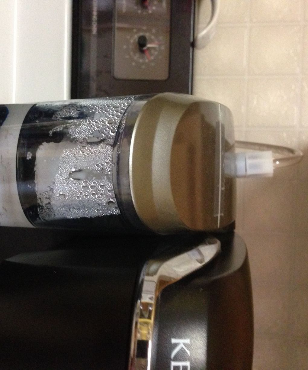

Now that you can blink an LED by entering a web address, all you need to do is connect the Keurig coffee maker to the Arduino Yun. There is more than one way to accomplish this, but I suggest you use a reed relay and solder your connections.
Unplug your Arduino and Keurig from the wall.
Use jumper wires to connect the Arduino (specifically Pin 13 and GND) to the two coil contacts on a 5VDC / 120 VAC 1amp reed relay. Solder the connections at the reed relay. Next, you will connect a red and a black wire to the inside of the Keurig coffee maker. Make sure you unplug your coffee maker from the wall and remove the water tank. Place the coffee maker on its back. Some water may leak out; dry it up immediately.
You will have to remove about five screws from the bottom plate of the coffee maker, then carefully swing the bottom plate aside. There is no need to cut the green ground wires. With the coffee maker on its back, locate and pull out the red and black wires on each side of the power switch. Cut them so that both ends are long enough to strip about ½ inch. Cut a 10 inch section of red hookup wire and another black wire the same length. Strip ½ inch from one end and about ¼ from the other. Take the red wire and twist and solder the ½ inch end to the two red wires inside the coffee maker; do the same for the black wires. Insulate the two soldered trios separately with a heat shrink or electrical tape. Feed the two 10 inch wires out the opening for the power cable and replace the bottom plate. (See photo.) Sit the Keurig upright and replace the water tank.
Attach the ¼ inch stripped ends to the COM and N.O. (doesn't matter which) contacts of the reed relay and solder them. This is optional, but I attached the Yun to a 3x3 inch panel board using standoffs, then attached velcro to the back of the panel board and the back of the Keurig. Plug in the Yun and the Keurig and watch that the green and white LEDs light up on the Yun. It may take a couple of minutes for the white LED (WiFi) to light up.
If your Keurig turns on when you plug it and the Yun in, you should be able to turn it off by going to http://your_arduino_ip:81/arduino/digital/13/1 where the 81 is the port you chose when configuring the forwarding. If you did not choose port forwarding, omit the ":81" portion. By the way, this same address turns the Keurig on.
