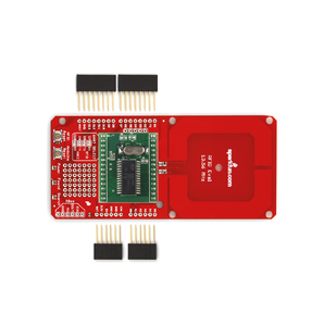

We are going to start connecting the parts that should be attached together.
In my case, the RFID module was already connected, but I'll show you a simple scheme to know where and how to connect the first part.
Connect the SM130 Mirafare writer with the SparkFun RFID Evaluation Shield. In the next Image you will see where to connect it and a simple scheme with the PinOut view.
Step 2: Step 2: Connect the RFID and the Arduino UNO
Now it's time to connect the RFID with the Arduino UNO. For this step we are going to need the RFID part we already did, the Arduino UNO and the stackable headers.
I did a simple scheme to know where to connect the headers and where to connect each component.
It should be at the end as in the last 3 pictures.
After do it, if you want to ad a LED, I put it connected to GND and D13.
