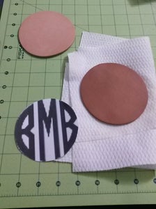

Use a precut piece of leather or cut your own. Mine was a piece from a leather kit.

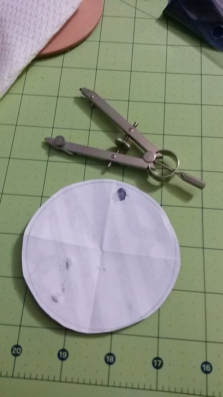

Design your monogram and print it out or draw it yourself on a piece of paper no thicker than average printer paper.
Cut it out as precisely as you can then fold it twice to find the middle.
Use a compass to make sure it is perfectly circular and trim to the compass mark.
Dampen the leather and pat dry.
Lay the pattern on top of the leather and use a modeling tool to trace the design.

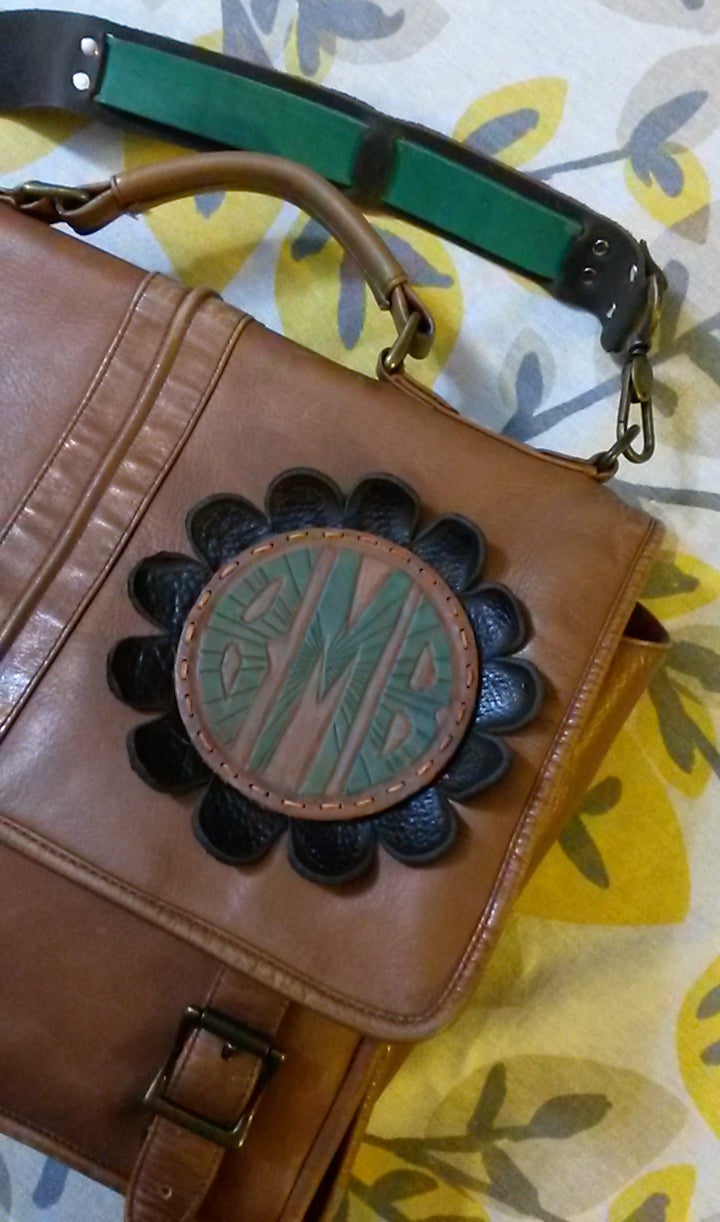

Step 3: Embellishment
I decided to add a pattern of rays to the lettering.
Mark the center and use a ruler and the modeling tool to draw lines radiating from the center.
Continue to use the modeling tool to embellish as you wish.

Step 6: Sewing to Bag
Use a running stitch with waxed thread to sew the monogrammed piece to the contrasting leather.
The larger holes in the contrasting leather are going to come in handy now.
Place the monogram where you want it on your bag.
Place the stylus through one of the holes in the contrasting leather under the edge of the monogrammed piece. Use your mallet to punch a hole into the bag.
Carefully remove the stylus and thread your needle into the hole. Repeat this hole punching/stitching process to produce a running stitch until it is fully sewn onto the bag.

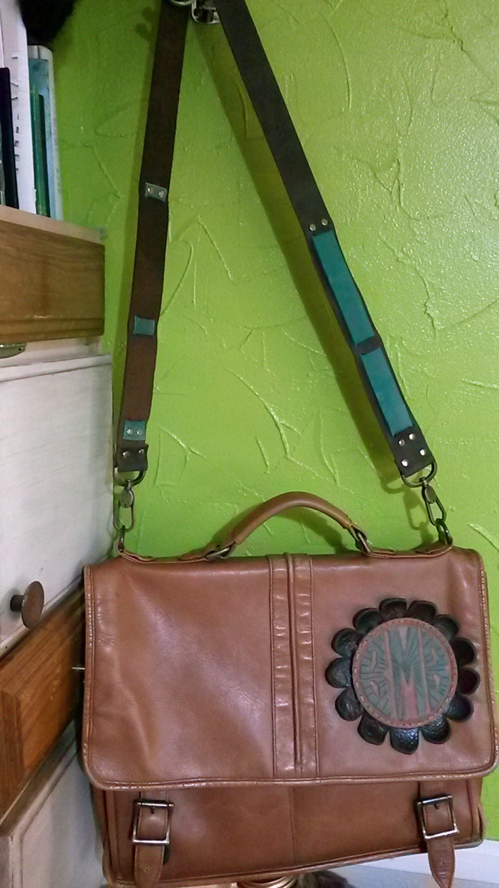

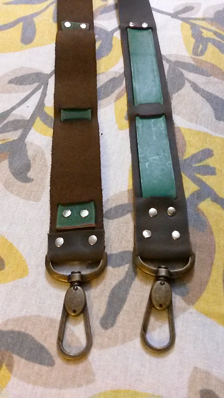

Step 7: Strap
The bag I got had no strap, so I needed to make one. I decided to use the Rit again to dye a couple small pieces with the same color I used on the monogram to unify it.
Step 8: Enjoy
Carry your things in style.
