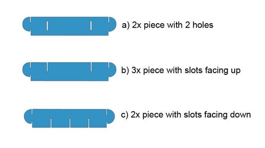

Step 4: Assembling the Bottom Part of the Ferris Wheel
Please have a look at the pictures, there is a legend with the description of the parts.
You need the 7 cross pieces
a) 2 pieces with 2 holes in the middle
b) 3 pieces with slots from the top side
c) 2 pieces with slots from the bottom side
- Slide the first a) piece in the first slot of the Ferris wheel side stand.
- Continue with the 3 b) pieces, slots facing up
- Finish with the second a) piece in the last slot.
- Slide the 2 c) pieces into the holes of the first a) piece.
- "Weave" the cross pieces together and slide the other side of the c) pieces into the holes of the second a) piece.
- Slide the 5 pieces into the second Ferris wheel side stand.
Check whether you have lost one or both of the fixing disks. This might occur while turning the whole element. If they have fallen down, simply put them back in place.
