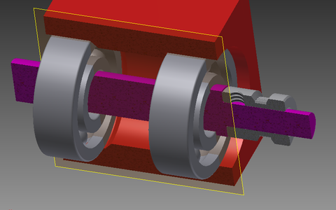

Step 1: 3d Print the Hobbing Rig. Then Make the Shaft
Hobbing is the process of using something like a tap called a hob. In fact, I'm using a tap for my hob :-)
Basically, you 3d print the hobbing jig. That's the easy part.
The harder part is making the shaft. I did that on the Jet Mill. Sorry no photos, but this was my first project on the lathe, and it wasn't that easy :-/
See attached STL and PDF for the parts you need to make.

Step 3: Hob the Parts
In this step we turn the blanks into pinch wheels!
Tools used:
Tools used:
- Mill
- Hobbing rig made in step 1
- 6-32 tap
- oil, cutting fluid, etc.
- Clamp hobbing rig into the mill's vise
- put drill chuck into mill
- mount 6-32 tap into the drill chuck
- set speed to about 1000 RPM
- put oil/lubricant on part & tap
- put the blank onto the hobbing shaft.
- turn on the lathe. MAKE SURE IT'S GOING THE RIGHT DIRECTION! Ensure that when the part moves into the tap, the tap will have a tendancy to push the part closer to the bearing. Otherwise the blank will simply be shoved off the shaft and you will almost certainly break your tap.
- slowly move the workpiece towards the tap. You just need to get the feel for this. Once my tap started hitting the base of the groove, I went about 15 thousanths farther.
- Let it run for a bit. Use lots of lubricant to wash chips away. I didn't, but should have.
