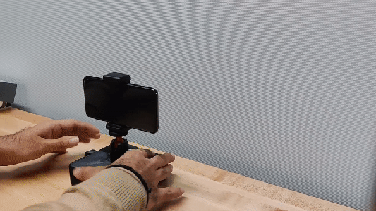

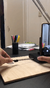

The special thing about the komelon measuring tape is that the silver disc behaves as a push lock. The harder you press the silver disc, slower the tape releases. Slidee uses this feature of the tape measure to enable speed control with the help of the rotating disc. If you tighten the rotating disc, it presses the silver lock of the tape and Slidee slides slowly. On the other hand if you loosen the rotating disc, the push lock of the measuring tape is disabled and slidee slides faster (better for heavier cameras).
Step 6: Make Sure It Slides
Slidee can slide in straight as well as curved paths to take curved sliding shots of smaller objects. Just turn the wheels (second picture) so they form an arc and slidee should now rotate in a curved path.
