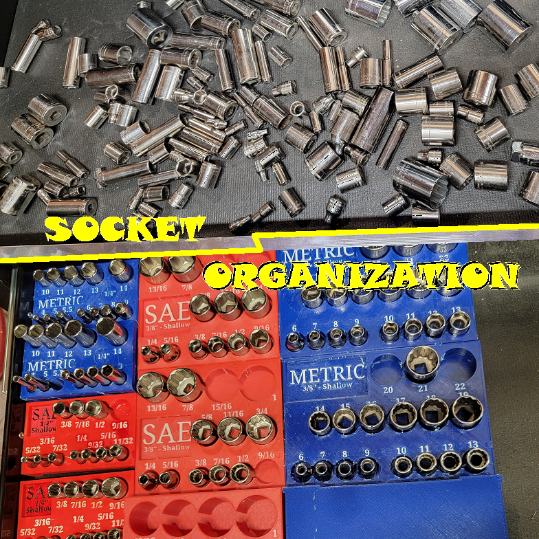

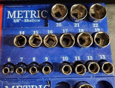

I have long desired a better way to organize my sockets in my Husky toolbox. After searching for and not finding quite what I wanted, I found that I just needed to design my own.
So, here are my Socket Organizers.

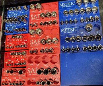

Step 1: Requirements
As with any design project, I first set out to determine what I wanted.

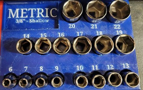

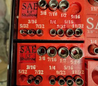

- Socket end up - I want to be able to see what I am grabbing; 6-point, 12-point, size. I find that when I am looking for a tool, I look for the size visually as opposed to reading the size.
- Easy to grab - I am a large person with big hands. I don't want to have to pinch my fingers down to fit them in to grab a socket.
- Low profile - This is really the biggest issue that I had with the trays available on the market, they don't tell you how high the sockets sit off the drawer. I want my Deep sockets to fit in my shallow drawer, which means that they need to sit only about 2 mm from the drawer.
- Grouping - I want to try to group the sockets by the most commonly used. Even if you disagree with what I think are the most common, it still puts the sockets in groupings that will be memorable.
- For SAE: 3/8", 7/16", 1/2", 9/16"
- For Metric: 10, 11, 12, 13mm

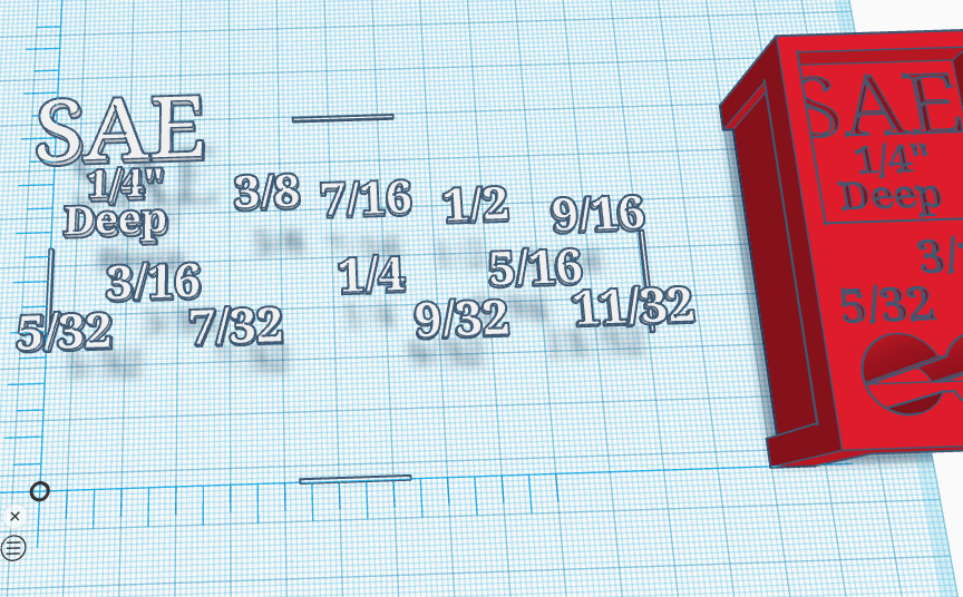

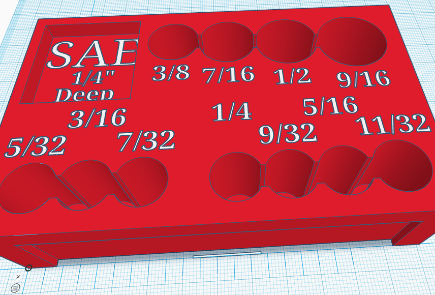

Step 2: Design
For the design of my trays, I used TinkerCAD.
Following are the steps that I took during design:
- Determine what socket sizes should be included for each ratchet size. (My socket set is a Craftsman Mechanic's set but does not include all of the socket sizes that larger sets have.) To determine what could be included in a socket set, I went to the Craftsman website and searched for individual sockets. Another good site for determining this would have been McMaster-Carr.
- Layout the sockets in patterns that allow for grouping by common use and give easy visual identification. Basically, I am trying to create patterns that would allow me to put my hand on the socket that I want without really looking at the tray.
- After layout, it was found that I had areas of empty space on my tray. This quickly became recessed to allow for temporary storage of nuts and bolts.
- After achieving tray arrangements, I then added some indents to the sides to assist with grabbing the trays. It is not my intent to remove the trays from my drawer, but if I did, I figured a little lip for the fingers to grab would help.

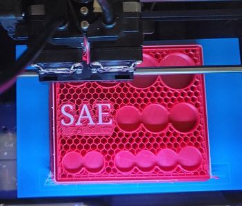

- Design requirements for 3D Printing:
- Base model - This model was the initial design with recessed letters. This was intended for easy painting of the letters. This design would also allow for strategic filament changes on a single extruder printer if I chose to printer the letters in a different color. (see Single Extruder section.)
- Dual Extruder Model - This design fills the letters of the base model for a 2nd color for use with a Dual Extruder printer. This design also includes alignment lines that are there only for the purpose of aligning the text to the base when printing.
- Red will be used for SAE sockets. Blue for Metric.
NOTE: I did not have all of the sockets for measuring. I estimated the size for those that are not in my tool box.

Since these trays will be in my toolbox in my un-insulated garage, I chose PETG and ABS as my preferred filaments for this project. PLA is the easiest to print but may distort in the heat. I printed with 15% infill, 3 walls, 3 bottom layers and 6 top layers.

Step 5: Technique #3: Dual Extruder - Multi-color
Printing:
For Dual-Extruder printing, I use a FlashForge Creator Pro.
Creation of printer code involves selecting one extruder for the base (Red or Blue) and one extruder for the text (White). I have to then center the files over the top of each other. To assist with this, I have added lines that line up with the outside edge of the socket.
Print Settings:
