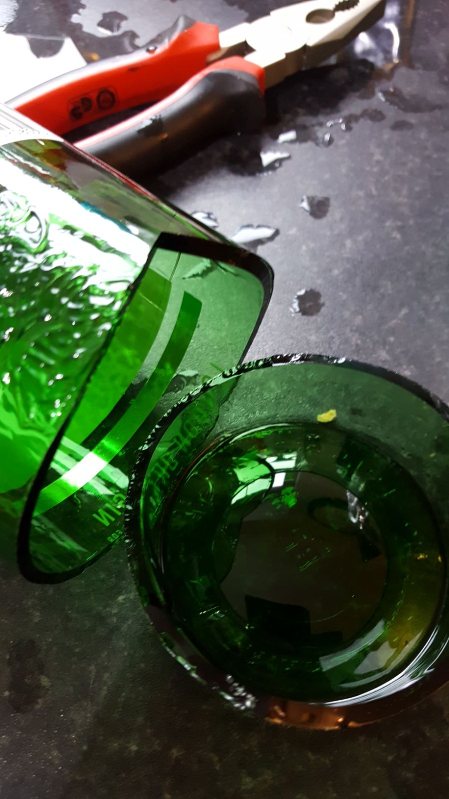

To remove the bottle bottoms I started off using the scored line and thermal shock method. I made a small jig to score the bottles and then tortured them with my kettle and cold tap. I did five bottles and each one went pear shaped. As you can see in the second photo on this page a a small section always tapered off towards some unseen flaw. Perhaps because the spirit bottles are thicker than beer/wine bottles?

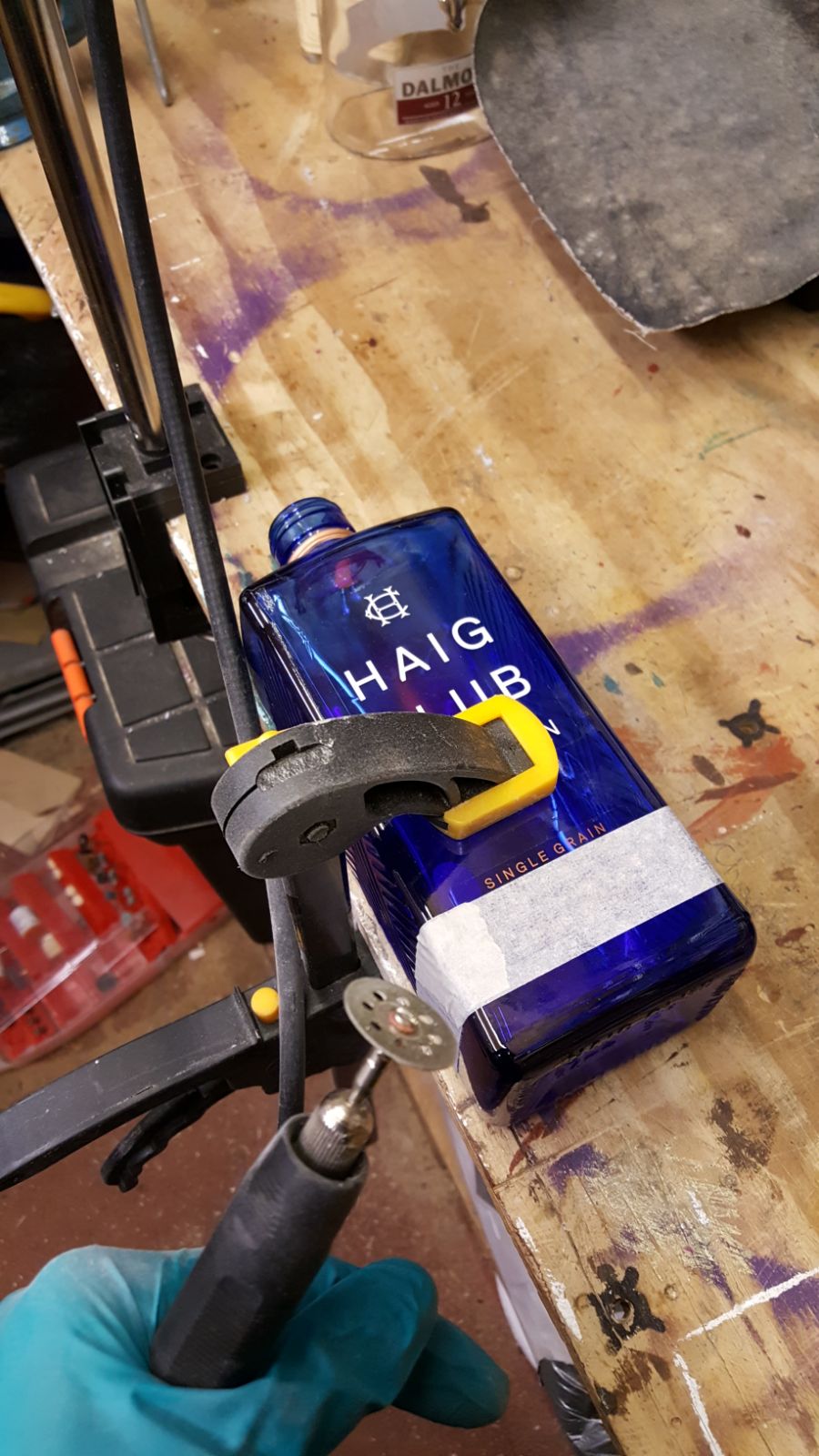

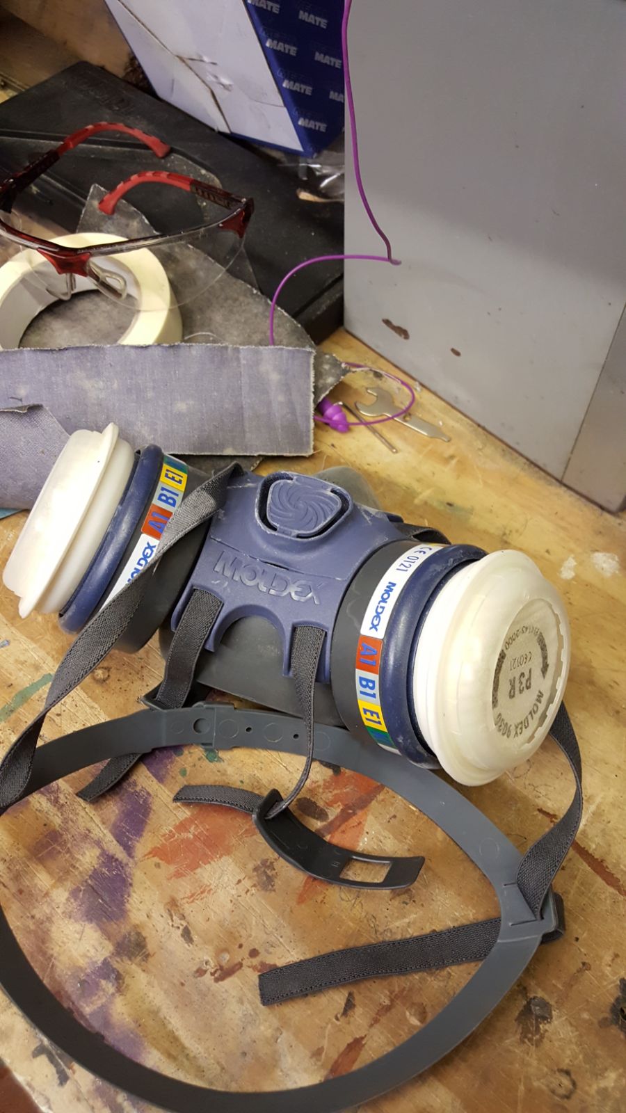

So I decided to try a diamond disc in my dremel, wearing my riot gear (mask and goggles), I slowly cut out a line one each side rotating the bottle so that I didn't go all the way through one side before I had made my way into the others. It worked quite well, I found that a strip of masking tape helped guide my cuts and also reduced the chipping.

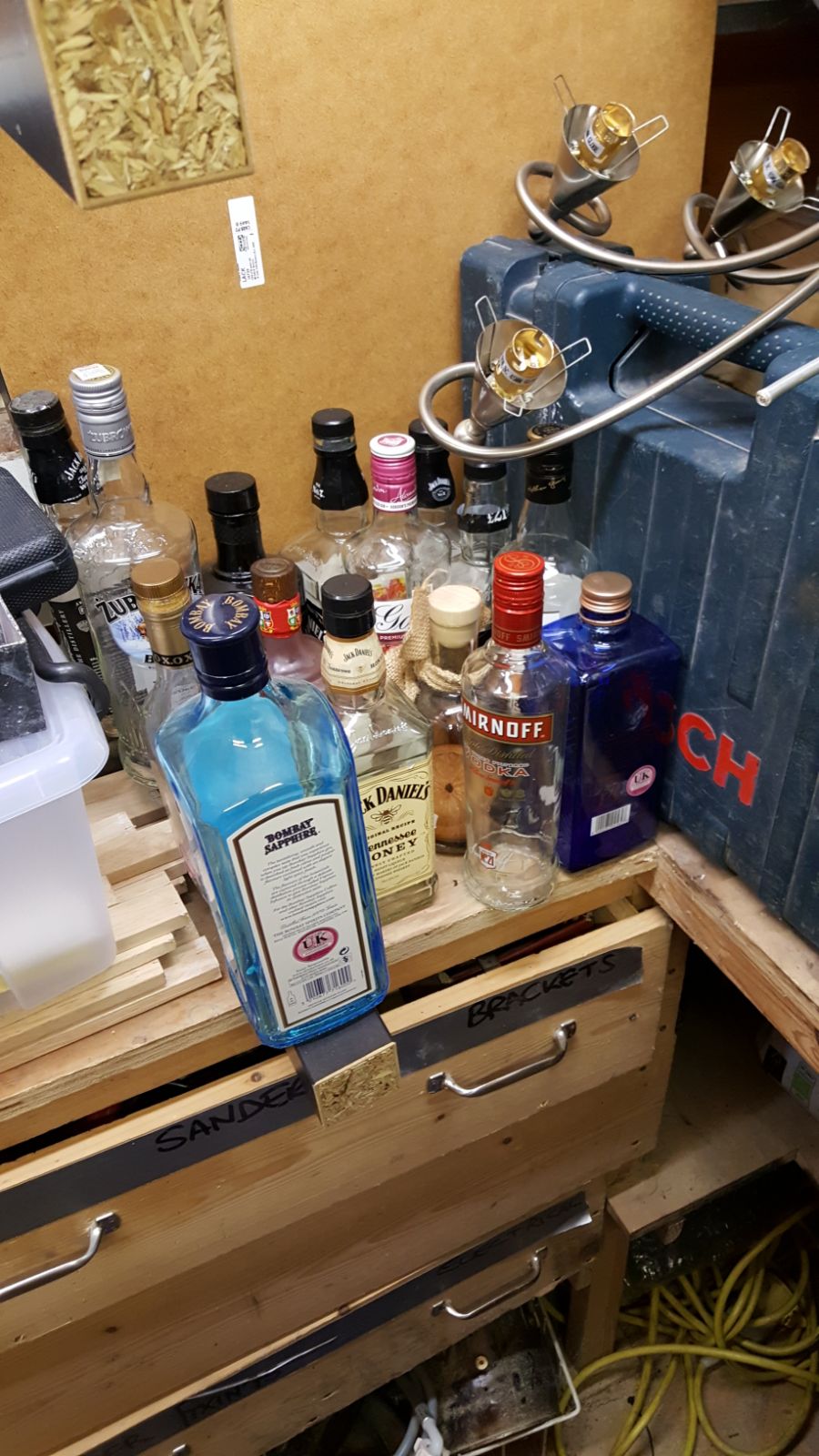

We had recently taken down a ceiling light in our dining room, so I stripped it down and stole the light fittings, the ceiling mount and took inspiration from its wiring loom. I also noticed a way for me to hang the lamp from the ceiling mount using some threaded bar.

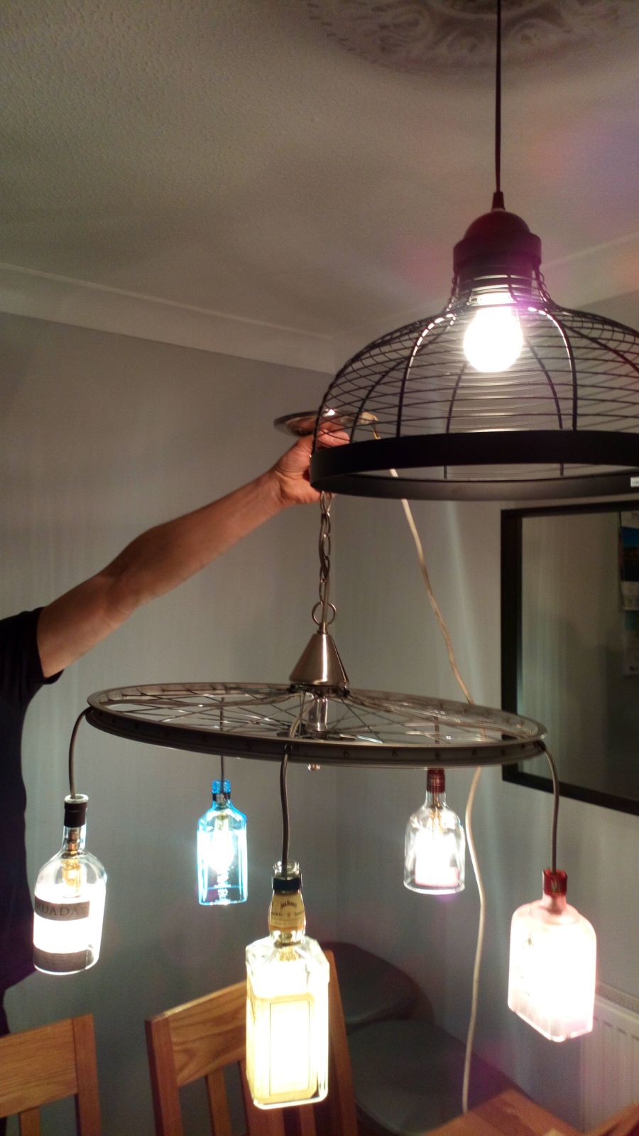

I gave the final line up a check over, there was still a difference in some of the weights but nothing massive. I also wired up one of the pendants to make sure that it worked. I've got to admit i did half expect to get zapped by 240 of the national grids finest volts at this point! I'm still here.
I drilled equidistant holes in the wheels rim for the wiring to pass through and then fed the lamp fitting wiring up the bottle necks, through the rim and positioned it over the hub to see how long the pendant cords needed to be with the ceiling fitting in place.
I was still grumbling at myself about the smashed Haig Club bottle, so I took precautions and shredded one of lady shed freaks fluffiest bath towels. After feeding the all pendant wiring through the wheel and into the disc which retained the arms in the old lamp I joined and soldered them. Then I finished wiring it to the ceiling fitting and secured the wires to the spokes with plastic tie wraps and it was ready to hang!!
Step 6: Ta Da!!
I asked my mate if I could hang it in his bar which I helped him to build last year, and he only went and asked Noel Gallagher to come and do the official switch on!! I didn't have the heart to tell Noel that I was more of a Blur fan........
I'm really pleased with how the lamp turned out. The JD honey label looks great as the light passes through it, and the colour of the Bombay and Slingsby bottles stand out well
I did consider putting another hole in the rim for each wire to pass back inside of it so that the pendants hung down on the inside of the rim but sometimes you can over think a thing. I had to adjust the brightness of the photos on my phone as I took them because it didn't depict what they really looked like to the eye.
