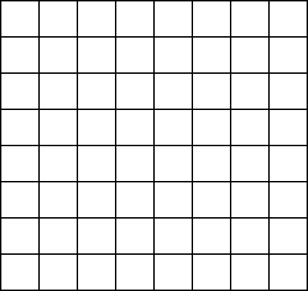

The idea I started from was very similar to the one in the “Tetrakis Square Tiling With WS2812 LEDs” project, except that instead of pieces of LED strips I used square LED matrices of different sizes but with the same number of LEDs horizontally and vertically to ease the programming. Also, another value that I considered is the "cell". This is the group of LEDs that I will reflect horizontally and vertically in the LED array to generate symmetrical figures. The minimum cell would be a group of 4 LEDs, 2 rows and 2 columns.
The next cell for mirroring would result by doubling the number of LEDs horizontally and vertically, ie 4x4 LEDs (16 in total)
and finally, the third cell is obtained by again doubling, resulting 8x8 LEDs (ie 64).
This last cell would represent half the horizontal and vertical dimension of the LED matrix that we use, ie 16x16 LEDs.
The following mirroring functions and default display types are shown:
  • 2x2 cell without mirroring;
  • 2x2 cell mirroring horizontally;
  • 2x2 cell mirroring vertically;
  • 2x2 cell mirroring horizontally and vertically;
  • 4x4 cell without mirroring;
  • 4x4 cell mirroring horizontally;
  • 4x4 cell mirroring vertically;
  • 4x4 cell mirroring horizontally and vertically;
  • 8x8 cell mirroring horizontally and vertically;
So a total of 9 functions.

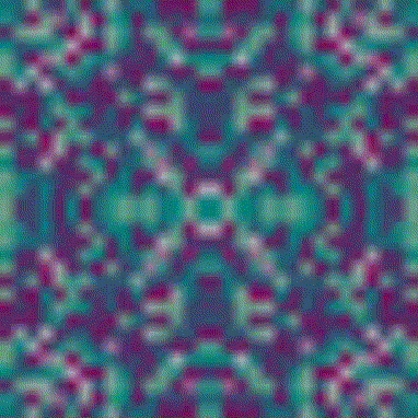

And the result, as you can see in the gif below, is great!
Step 3: An Unusual Usage...
Seeing the results from the gif above, it occurred to me there might be a way to use the generated images from it.
So I simply paused the simulation on an interesting pattern and with the help of paint.net, a freeware image processing program and applying some simple transformations and effects, I got interesting ( and original :) ) textures. You can see some of them attached above.
