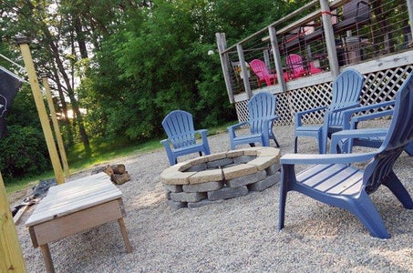

An inexpensive stone fire pit set in our new pea gravel lower deck. Our previous fire pit was totally surrounded by sand so it gave us a lot of piece of mind, HOWEVER, it was sunk entirely into the ground so it wasn’t exactly safe to dance around! One wrong step and BOOM you were literally in it! That, obviously, always bothered me so I’ve been working on a plan in my head for awhile now for a much safer stone pit that wasn’t quite so easy to fall into. In fact, I decided to take it a bit further and designed the top of it to make a nice spot for a foot rest or even to sit on.
Who doesn’t love the idea of having a nice spot to put your feet up by the fire or, even better, to sit right beside it to warm up?

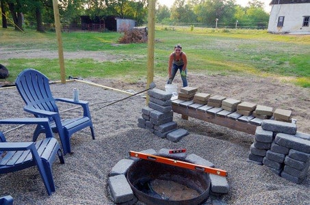

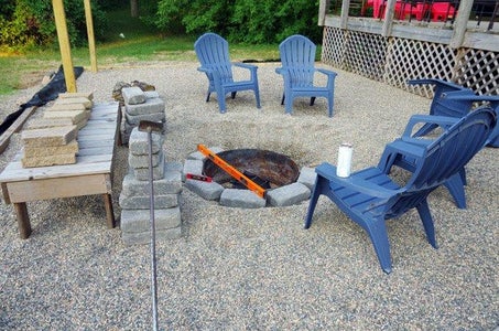

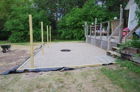

Stage one of our new lower deck was prepping the space with a bob cat, digging out the pit and inserting our steel fire ring as well as putting in four new posts. We also covered everything with many layers of landscape fabric, had our pea gravel dropped off and surrounded the entire deck with 4x4s bringing us to this last step. We picked up these pavers / bricks at Menards to build the ring out of and the flat pieces for the top. We also picked up a six pack of Gorilla glue construction adhesive, two bags of quickcrete and it was time to get to work! Like I mentioned in my last post this lower deck was not priority number one this summer at all however, we had to rent a bob cat to prep for our garage slab so it only made sense to go ahead and get this ready too.

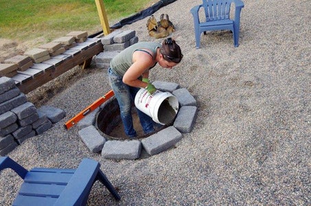

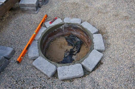

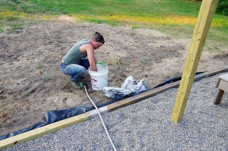

I got really excited! I mixed up the quickcrete in a 5 gallon bucket intentionally mixing it REALLY thick. I knew our fire ring wasn’t level so that was my first priority with the first layer of bricks. I used two levels to get this done, the four foot level working across the entire pit as I went and my little level to get each individual brick as good as I could. I ended up using almost two bags of concrete. Once I got all the base layer stones concreted in I then mixed my last batch of concrete very wet and literally poured it between the base layer stones and our steel fire ring. Attaching the stone to the steel like that gave me a lot of peace of mind that these stones are going NOWHERE.

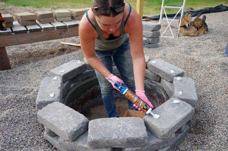

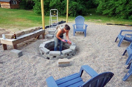

I simply assembled it by gluing the bricks together and stacking as I went. I had a moment here, looking at it, that I was about convinced we’d have to go back to Menards for more stone. Our pea gravel is so deep the first two layers of stone were covered up – meaning it ended up only half the height we had planned it to be! We put the top stones on dry,

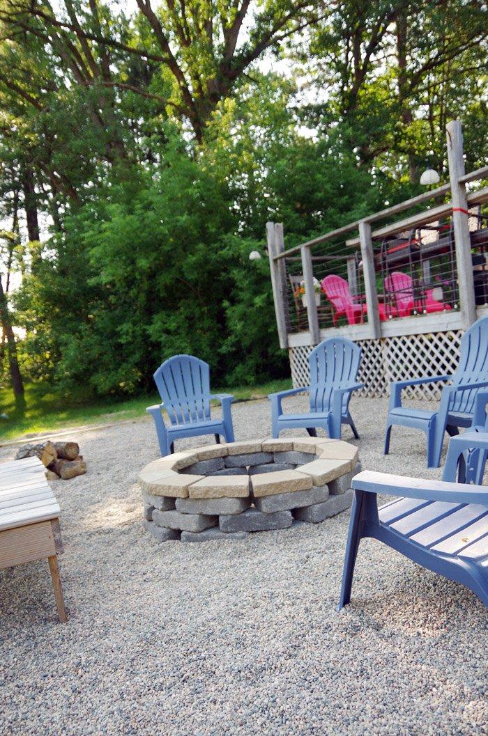

I wanted a stone fire pit that looked old school and I think I achieved it. Initially I was going to go with much smaller stones but after all of that I finally decided that the larger ones made a lot more sense. For one thing, there would be gaps between the stones which would help a fire breathe. For another thing, I felt they had an older look to them that fit our 100 year old home a lot better. For another thing it meant one stone for the size of two of the smaller stones. We used 36 of the gray stones and 12 of the beige stones.
I probably would have just done gray upon gray but Lodi’s idea to do the flat upper bricks in a brown was a really good one. I love how the two colors of the stone fire pit pick up the colors of the pea gravel so well. We were chilling after work on our deck one day and we both realized that I didn’t just build us a stone fire pit.
I built us what kind of looks like an old well! This Halloween I am totally going to have to crawl out of that thing like the girl from The Ring. I just need a creepy old night gown and to let my hair down… Jokes aside, we are VERY happy with how it turned out! NOTE: Yeah I was a bit concerned using gorilla glue and not concrete to hold the stones together but every single build I’ve seen like this one on youtube they use construction adhesive. So, I trusted them, and went along with it. When we had our first fire we got it REALLY hot and had absolutely no problems whatsoever. Since then we’ve had dozens of fires and those stones have not moved an inch!
