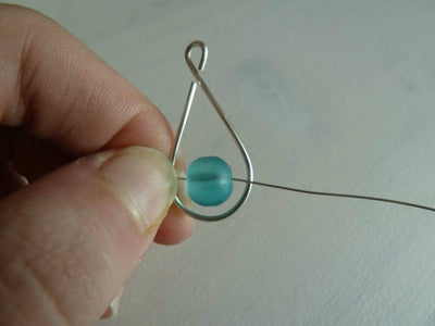

Cut off a long piece of your 0,4 mm/gauge 26 wire. Find the middle and mark it. I just used the orange marker I also used to bend the base around. Basically anything that won't show up through your bead will suffice.
Note: I changed the bead here, I thought the brighter blue would just look a bit better in the pendant.
Put the bead on the middle of the wire. Find the exact place you want your bead to be and hold the wire in this position.
Step 8: Time to Coil
Lock that perfect location by coiling both ends around the base a few times as shown. When you just start coiling, it will still shift quite a lot, so I'd recommend to keep it in position as good as possible.
