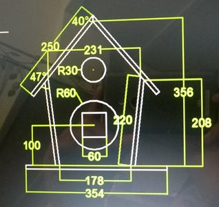

First I drafted the dimension on a drafting software. This is to prepare for the cut. My main materials for this clock are:

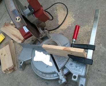

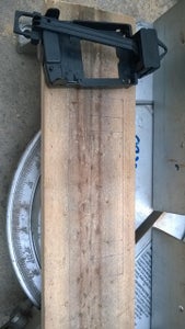

I used the miter saw and chopped the pallet planks into the dimensions: 2 pieces for the sides, 2 for the roof and 1 for the bottom.
Miter saw is a very useful tool for this job because we need the corner deg cut for the sides and the roofs. If you have a table saw or a circular saw that can make corner deg cut, that is nice too.
I cut the bottom piece longer than the side as you can see from the finished clock, I have a figurine and some dried flowers on each side.
Sand those pieces smoothly and get them together

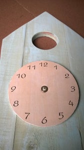

Step 3: The Birdhouse Front Face
See from my photos, I had 3 pieces of cut plank connected using a Kreg jig. Draw a pilot line on it and cut into the dimension.
To make it easy, I would suggest that after you finish the outside of the birdhouse, put it on top of the front and trace the inner line, you will get quite precise line to jig saw.
Cut a hole for the clock mechanism and a hole for the bird as well
Then sand the face for the paint job later on

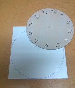

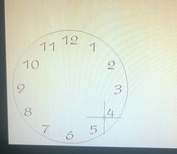

Step 4: The Clock Face
I drew the clock face using a computer software, printed it out, cut it and glued it to a piece of carton paper, then cut the carton paper

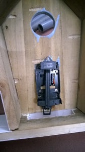

Step 6: Install the Clock Mechanism
Drill the center hole for the clock, then install it and fit it to the square pre-cut hole on the birdhouse front face. I used double glued tape to stick the windows onto the front face. And fit the whole front face onto the birdhouse frame. They're tightly fit, so I used nothing else to keep them together.
