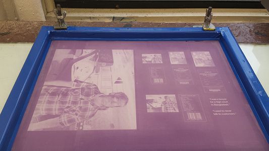

Step 1: Clamp Screen & Tape
The first step is to clamp your screen down on the table. Make it tight so that the screen may be lifted like a cover over the table. Tape over the immediate parts that you do not want to screen, leaving the part you want to print exposed. In this case, we start with the text that will be underneath the photo.

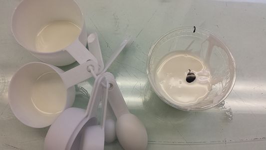

Now to get the ink ready for the text. I used about a half cup of silkscreen base with a half teaspoon of black ink. Add a drop each of reducer and retarder and mix well.

Repeat Steps 1 & 2 for exposing the image on the screen for printing. This is the layer that will go over the text.
Now for the key moment: For the heat sensitive image, I mixed a half cup of silkscreen base with two tablespoons of black thermochromic pigment. Do not add ink if you want it to fade clear when touching the print. Mix the base and pigment with a drop of reducer and retarder.
