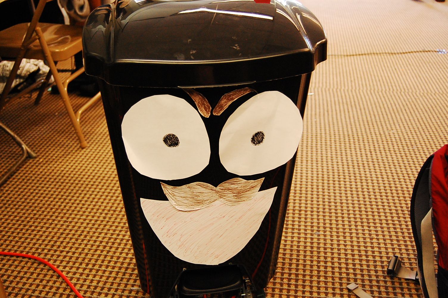

As a way of learning basic programming and electronics, I attempted to design and create a trashcan that uses an ultrasonic sensor to detect the fill level of a trashcan, and a one digit LED counter to display how full the can is in an intuitive way. The counter displays an LED representation of the can and indicated that the can is full, halfway full, or less than halfway full. The can is controlled by an Arduino Uno powered by a 9.7v battery.

Next, we need to put on the brains of our waste receptacle. I used an Arduino Uno to power this project. I located the micro controller close to the routing hole for my wiring, and next to the limit switch. This Arduino is attached using three screws of an indeterminate size screwed directly into the side of the can. I also considered using zUNO Clips ( http://digilentinc.com/Products/Detail.cfm?NavPath=2,892,1256&Prod=ZUNO-CLIP), but didn't have enough printer time to get them done. Once the Arduino is mounted, it's time to start wiring. Its fairly straight forward, but there are a couple of things to note. If you are using a VEX limit switch, the black wire actually need to go to a constant 5v port on your microcontroller. You also need to add a 10k resistor stemming from the signal wire of the switch into ground. This is important for receiving a clear signal from your switch. Also be sure to wire the pins for the outside indicators of the counter straight to ground, unless you want them to be individually controllable.
