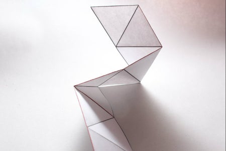

Step 3: Trihexaflexagon: Preparing the Template
Cut the template out along the outside outline and then make a mountain fold (line side out) down the middle line. Fold on each line back and forth so that you make assembly easier. Try to be as exact as possible so that the trihexaflexagon looks neat. Once all the folds are made, then apply glue to the inside of the triangles and stick it together.
Step 4: Trihexaflexagon: Assembly
Now for the tricky part: the hexaflexagon assembly. If done incorrectly then it won't make a hexaflexagon. It is stressful when it doesn't work the first time but don't be discouraged. Follow along with the pictures and it should help clear up the assembly.
How the 10 triangles are oriented is important: hold the strip of paper with the left hand triangle's top corner away from yourself. It should look like the first picture.
Then, near the right side, there should be a dotted fold line 4 triangles in on the right side, fold this forward or backward depending on what you want; personally, I folded it backwards. On the left side, fold the 3 triangles on the dotted line the opposite of what you did on the right side. I folded it forward.
Finally, tuck the left side underneath the right side (or vice versa) and there should be a triangle sticking out on top. Apply glue to the top two triangles and then fold the triangle down (see pictures for reference).

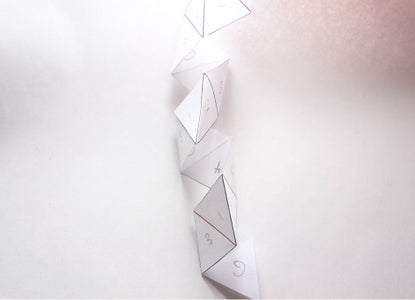

Start by cutting the template out similar to the trihexaflexagon but this time, cut down the mid-line to split the paper in half. This will create two strips with 10 triangles each. Take the two strips and apply glue to the back of one of the triangles (side with nothing printed on it). The triangle should be facing with its top corner facing away from you. See the third picture for reference. This will result in 19 triangles in a long row. Then with the left side's triangle pointing away from you, start to number the triangles 1,2,3,1,2,3,1,2,3....
At the end, there will be one extra triangle at the end; put the letter 'G' on that triangle. Flip the triangle over on its long edge and then start with 4,4,5,5,6,6,4,4,5,5,6,6...from right to left (the first 4 should be on the back of the G) all the way to the end where your write 'G' again. (See the pictures for reference).
Step 8: Hexahexaflexagon: Folding the Template
I made a separate step because this step is very complicated and takes some time. Start by taking the full strip and folding it back and forth, similar to the way you did with the trihexaflexagons. This step was somewhat necessary with the trihexaflexagons but definitely necessary here. The folds facilitate the making of the hexhexaflexagons as well as flexigation later on. When you reach the glued triangle in the middle, it will be a little hard to fold but try to fold it on the line.
Once that is completed, make a fold between the first 2 and 3 on the left hand side of the strip (Picture 2). Repeat this fold between the next 1 and 2. Essentially, you are folding every second triangle. This should go quickly if you folded the triangles back and forth first.The structure will try to unravel but try to keep it down.
At the end, fold the glue triangle tab as well.
You will notice that once this is done you will have a strip very much similar to that of the trihexaflexagon.
