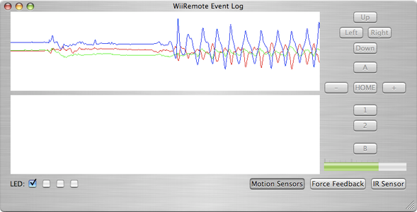

On your Mac, ensure that Bluetooth is turned on. Turn on one WiiMote (make sure there's batteries in it!) and open one copy of DarwiinRemote. On your WiiMote, press buttons 1 and 2 simultaneously. Shake your WiiMote and you should then see three lines (green, red and blue) moving up and down.

Same instructions as Step 3, but with a second copy of DarwiinRemote. So, turn on your second WiiMote (make sure there's batteries in it!) and open up a second copy of DarwiinRemote (keep the first one running). On your second WiiMote, press buttons 1 and 2 simultaneously. Shake your second WiiMote and you should then see three lines (green, red and blue) moving up and down. You now have two WiiMotes connected!!!
