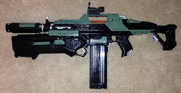

Step 12: Paint Your Gun.
If you have not been able to tell as of yet, I haven't followed my instructions as per the order I have given you. As for painting your gun, make sure that you use the right paint. I made the mistake of using bad spray paint for my primer layer and it cracked. This lead to a frustrating time of sanding to get rid of said cracks.
I originally wanted this gun to look like the one from Aliens, but after painting the first green spot I decided to just do my own thing for finish paint. Naturally, tape the areas you don't want painted the color you are painting. I used plastic spray paint and a clear varnish after.
Note: I painted all of the small parts a different color while the main guns were drying. I sprayed everything with the varnish at the same time.
