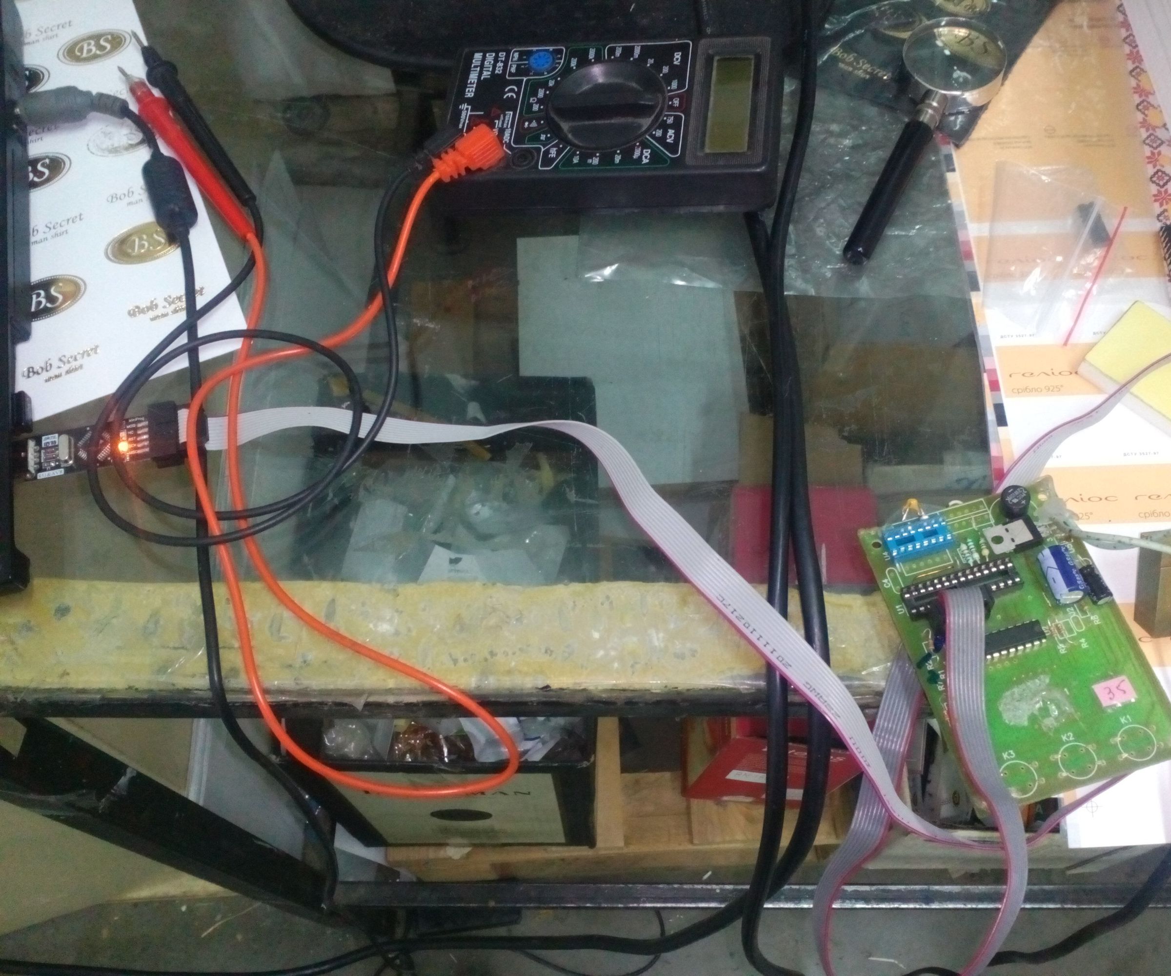

Step 3: Wizznet Bug and Fixing
https://www.arduino.cc/en/Main/ArduinoEthernetShie...
Bug that i found - problem with link up\down. Long time ethernet link up\down. Collision on link. Some time you'll need reboot board.
China make mistake on assembly(check place of bag on first photo). After RJ45 on datasheet is installed 50ohm resistor. China make mistake and install 50Kohm resistor
In attached photos how i fix this using what i have.
