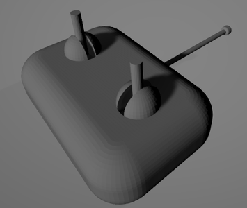

The algorithm used is analogous to an RC robot controller, with one lever that can be turned left or right, and another lever that can be turned forward or backward.
To seek light, you want this robot to move in a straight line if the position of the light source is right in front of the robot. To do that, you want the same speed on both the left and the right motors. If the light is located on the left side of the robot, you want the right motor to move faster than the left motor so that the robot can turn to the left towards the light. Conversely, if the light is located on the right side of the robot, you want the left motor to move faster than the right motor so that the robot can turn to the right towards the light. This is analogous to the left lever of an RC controller, where you can control whether you want to move the robot left, right, or straight.
Then, you want the robot to move forward if the light source is far away (small light source), or move backwards if the detected light source is too near (big light source). You also want that the farther away the robot is from the light source, the faster the robot moves. This is analogous to the right lever of an RC controller, where you can control whether you want to move forward or backward, and how fast you want it to move.
