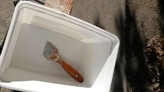

Procedures:
Sand the front of the boards smooth. Anywhere you plan to paint designs, will need to be extra smooth. This was the hardest and most time consuming part of this job. Wear a mask and glasses to keep the the dust from you face.
Water down some white paint to create a white stain.
Paint on the watery paint and let sit for about 5 minutes.
Wipe off the excess. This doesn't appear to change the color of the board much, but prevents it from bringing out the natural yellow of the plywood when the sealer is applied.
Set aside to dry
Apply wood sealer to the front and sides of the boards. DO NOT apply sealer to any boards you wish to paint the geometrical pattern on. You'll seal those after painting.
Set aside to dry.
