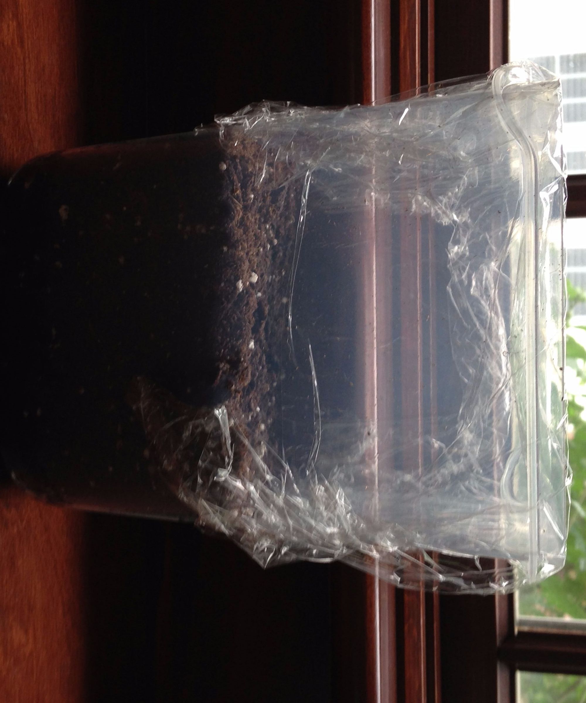

One of the containers does not need any holes. For the other one you need to cut a slit on the end of it for the felt using the X-Acto knife. Make a matching slit on the lid. Put the lid onto the not cut container ant tape the cut container on top, matching up the slits. Using the drill, drill 3 drainage holes onto the cut lid and base. If any of it cracks tape it with duct tape to stop the cracks from spreading.
Step 3: Put on the Felt
Cut the felt skinny enough to fit through the slits and long enough to go on the bottom of the not cut container, through the lid, and onto the bottom of the cut container. Put the felt through the slits in the manner described.

Step 5: Plant the Seeds
Put the soil down in the top container, leaving some aside to put on top of the seeds. Sprinkle the seeds on top of the soil. Add more soil on top. Add water until the bottom is full.
Note: I tested this first so my bottom reservoir is already almost full.
Step 6: Wait and Water As Neccassary
Wait for your seeds to sprout. If you notice the reservoir is low, water the plants.
