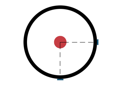

Step 3: Drilling
- Drill a roughly 1.5" deep hole in the center of the un-beveled end of the dowel using a drill bit the same diameter as your nail. Be sure to take your time! I rushed, and ended up with an off-center hole.
- In the third image, the "face" of the dowel is shown, with the center hole represented by the red dot. The two blue bars on the sides represent the holes for the magnets. The magnet holes should appear to be at a 90 degree angle to each other when viewing the face.
- Drill the holes for the magnets about a 1/2" in from the end of the dowel using a 1/4" drill bit. Since the dowel is round (of course), the holes will have an uneven depth; you want the magnet to be flush with the surface of the dowel at the "deepest" part of the hole.
