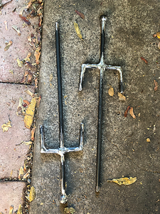

This Instructable is about making a real pair of sai (NOT FOR COSPLAY) by cutting and welding steel bars.

Measure sai dimensions and cut steel bars to match.
Sai come in different sizes and the size you use depends on the length of your arm. Holding a ruler or the steel bar in one hand with your index finger extended. Measure from the tip of your index finger to a 1 to 3 inches past your elbow. This the length of the main bar. Also make note of where the connection of your thumb and index finger is on the bar. This will be where you will weld the guard onto the main bar.
See the attached drawing of the dimensions for the guard pieces. If you want to go the extra step you could cut the pieces out of wood dowel first to mock the design up in wood before cutting your metal pieces.
Step 2: Weld
Now it's time to weld the segments together. Layout the segments on the welding table and use the MIG welder to weld them together. This in not welding Instructable and I'm not a good enough welder to write one. The important thing is to get a strong weld and join the pieces together deeply. The guard is designed to catch and block weapons so it needs to be strong.
Step 3: Grind Welds
Now it's time to clean up the welds.
Using the angle grinder, grind down any excess material on the welds and joints. You can also do some shaping at this point. Traditional sai have rounded corners and the tip of the shaft and guard are rounded. The sai was a law enforcement tool designed to disarm and catch opponents not kill them.
Step 4: Paint
To keep the steel from rusting you will need to paint it. I used a black primer and then a silver cover.
Step 5: Wrap the Handle
To finish off the sai, wrap the handle in paracord. There are plenty of insturctables and youtube videos on how to do a paracord wrap.
