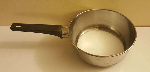

In a pan, cup, can or other receptacle, pour some sugar.
Either boil some water, pour water in the pan and cook it over heat, or otherwise let the sugar dissolve.
Allow the mixture to cool, or you may add water to bring down the temperature to below 90 F (32 C).
