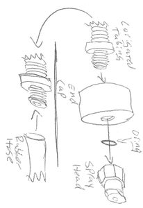

Drill a hole in the center of the 2" end cap to slide in JUST THE THREADED PART of the corrugated tubing. Slide tubing in hole, place Oring over threads and screw on the sprinkler head. Take other end of tubing and shove a few inch section of the rubber tubing over the exposed threads to take up the remainder of the paint chamber (leave some to cut off). This will be the sprayer assembly.
Step 4:
DO NOT GLUE YET, slide the sprayer assembly onto one ends of the paint chamber and then the 2" coupler with the female threaded sleeve on the other end. Insert Oring into threaded part. You do not want the end of the tubing to touch the threaded cap so cut off a section of the rubber tubing so it does not touch the cap.
