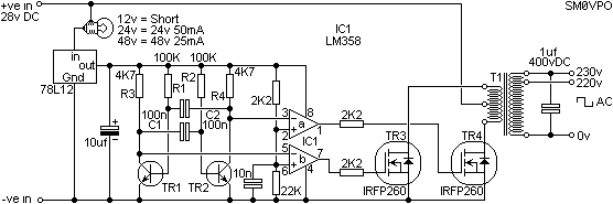

Can someone please try to explain how I can re wire a microwave transformer (or any other Transformer) to be used in a custom inverter. The input is 12 volts and the output needs to be 120 volts. Pictures would be great, thanks in advance.

Now if you are trying to do this with a 12 volt battery then you really do need an inverter like this one.
You can't use this for a computer of anything sensitive like that, but you could run lights off it.  It's not going to be frequency controlled and probably not true sine wave.
arenavles (author)  Re-design7 years ago
Sorry the link didnt add, here it is.www.sm0vpo.com/
There is the circuit.
Thank you for the answer, but I actually have a circuit for my inverter. The thing I cant get around for some reason is the transformer part.
Not my design but nice though. Anyways wanted to know if I can just re-wire a MOT to use in this circuit.
